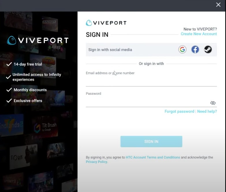

4. You will need to create a VIVEPORT account to complete the setup process
