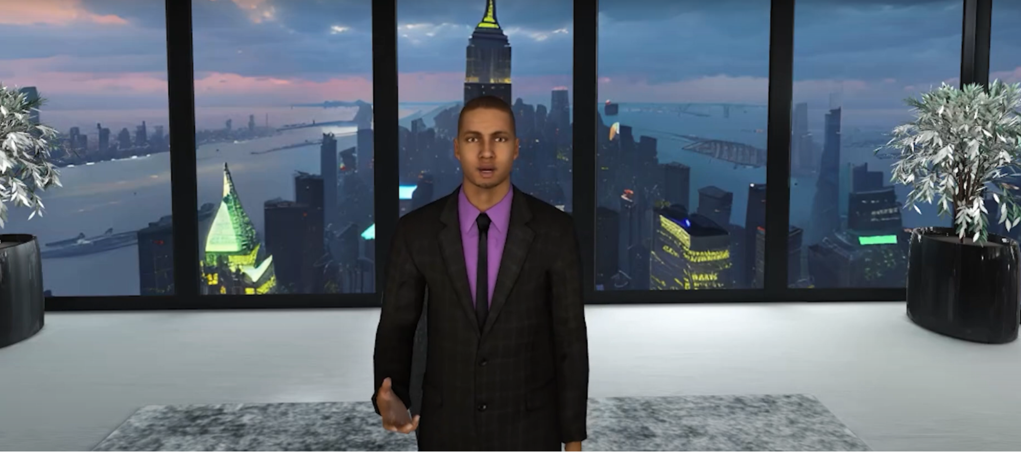

SightLab (the VR Experiment Generator for Vizard)’s AI Agent example lets you place intelligent, conversational avatars directly into your VR or XR scenes.
These agents can use cloud-based large language models (like Chat GPT, Claude, or Gemini) or offline models via Ollama, allowing flexible deployment even without internet access or sharing data.
They can act as:
  • Conversational avatars or digital confederates for social research
  • Educational assistants in virtual classrooms
  • Interactive characters in multi-agent simulations or training scenarios

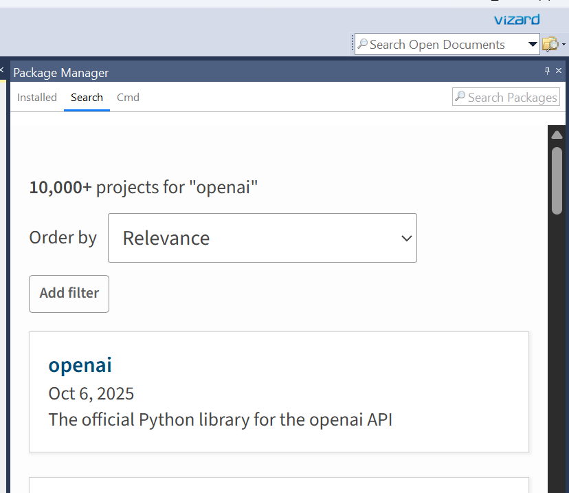

Step 1 — Install the Required Libraries
💡 Use the Vizard Package Manager for installation.
Core libraries
openai
anthropic
google-generativeai
elevenlabs
SpeechRecognition
sounddevice
faster_whisper
numpy
pyttsx3
ollama
Optional:
  • Install FFmpeg (for ElevenLabs TTS)
  • Install Ollama for local/offline models: ollama.com

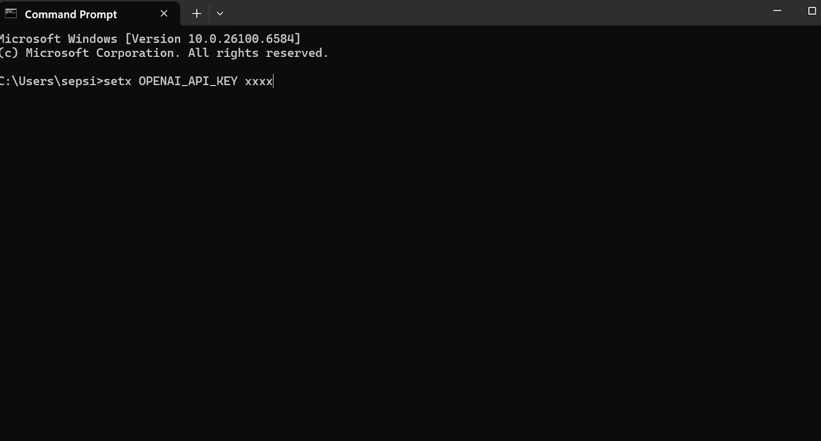

Step 2 — Set Up Your API Keys
You’ll need API keys if using online models.
Type CMD in Windows search to open a command line window and enter (depending on which api key you are using):
setx OPENAI_API_KEY your-openai-key
setx ANTHROPIC_API_KEY your-anthropic-key
setx GEMINI_API_KEY your-gemini-key
setx ELEVENLABS_API_KEY your-elevenlabs-key
Then restart Vizard.
Offline Ollama models require no API key.

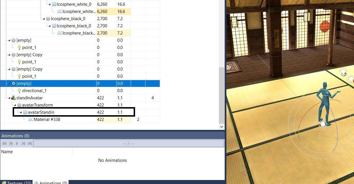

Step 5 — Placing the AI Agent Avatar in a Scene Using Inspector
To place the avatar location in your scene:
  1. Open the Inspector from the Tools menu.
  2. Open your specific Environment Scene
  3. Add an avatarStandin object from the sightlab_resources (C:\Program Files\WorldViz\Sightlab2\sightlab_resources\objects) by using File-Add.
  4. Adjust its position and orientation visually.
  5. Save your .osgb model

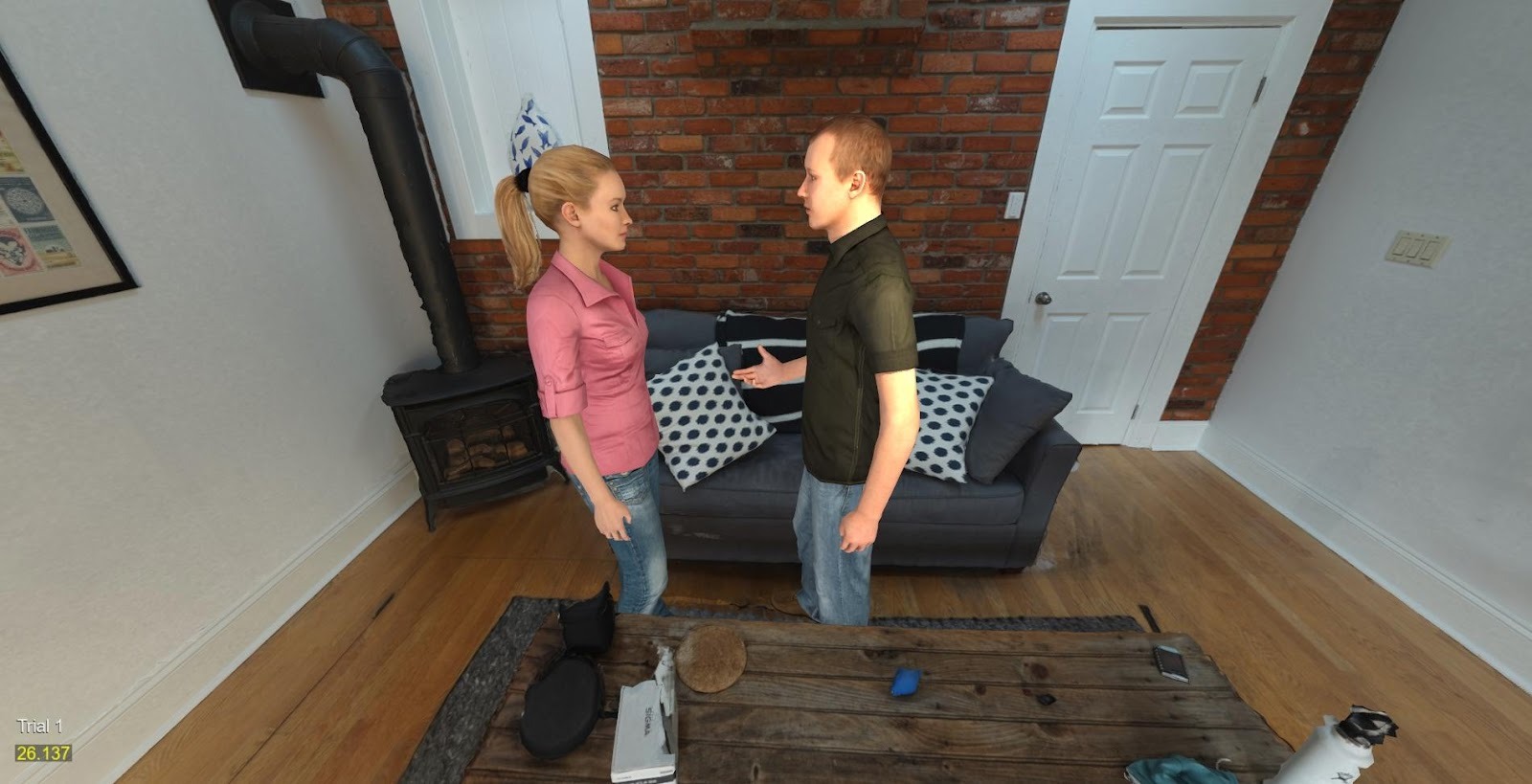

Step 6 — Multi-Agent Interactions
You can run multiple AI agents in the same scene using the multi_agent_interaction.py example.
from AI_Agent import AIAgent
agent1 = AIAgent(config_path='configs/Agent1_Config.py', name='Tutor')
agent2 = AIAgent(config_path='configs/Agent2_Config.py', name='Student')
Agents can converse with each other or respond to users collaboratively, ideal for:
  • Multi-character roleplays
  • Training simulations
  • Group educational scenarios

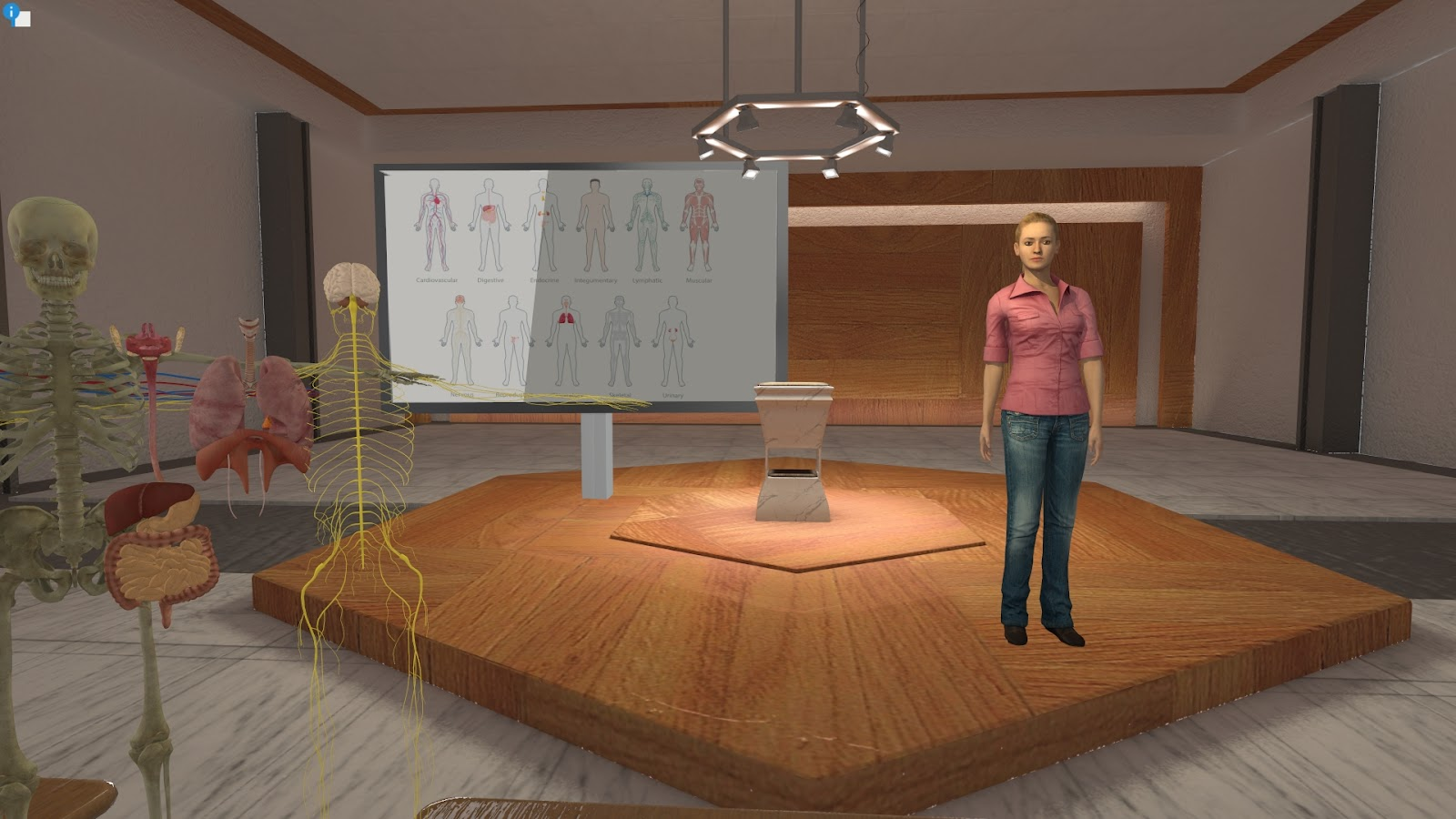

Step 7 — Integrating with the VR Presentation Tool
In Multi-User SightLab, AI agents can serve as:
  • Virtual lecturers or assistants that present material
  • Guides that respond to students’ questions
  • Confederates in behavioral or social experiments
  • Easily add a prompt to any slide by creating a new text file, adding it to the AI Prompts library and dragging it into your slide/scene
Combine with the VR Presentation Tool to display media, slides, or 3D objects while the AI agent narrates or answers in real time.
