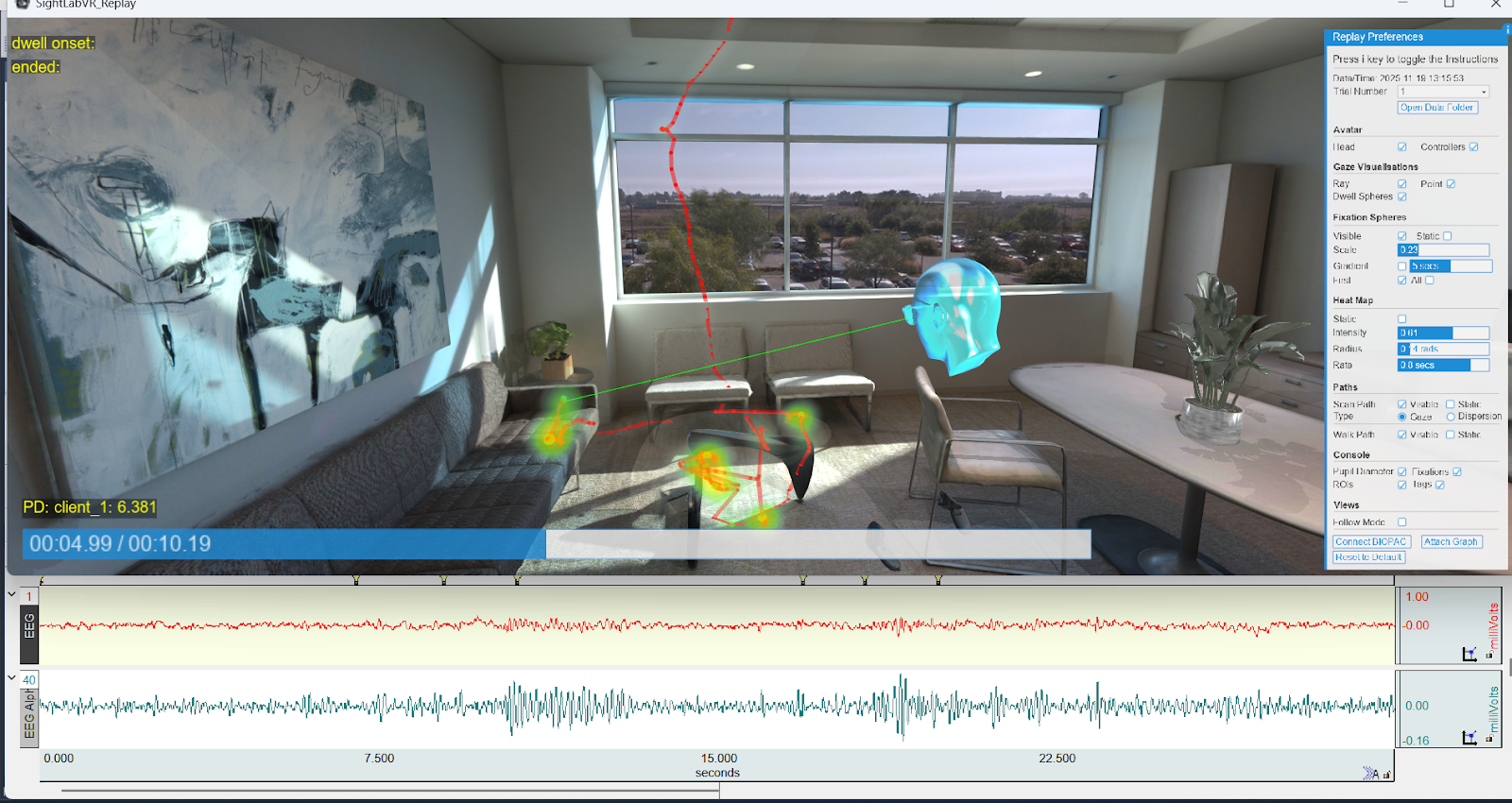

Synchronizing Session Replay Visualizations with Acqknowledge’s Graph
Starting with SightLab 2.6 and AcqKnowledge 6.02, you can fully synchronize AcqKnowledge’s playback graph with SightLab’s replay visualizations.
To use this feature:
  1. Open AcqKnowledge and load the graph file recorded from the same session you are replaying in SightLab.
  2. In SightLab’s Replay interface, click “Connect Biopac” to establish the connection to AcqKnowledge.
  3. Click “Attach Graph” to link SightLab to the first graph displayed on the left-most tab in AcqKnowledge.
Once attached, you can control playback in either application:
  • Drag the slider to scrub through the timeline.
  • Use keyboard shortcuts:
    • B / N — Step backward / forward by one frame
    • C / V — Jump backward / forward in larger increments
You can also adjust what is displayed using SightLab’s replay visualization tools—sliders, toggles, and visibility controls for gaze paths, fixations, dwell spheres, and more. This allows you to seamlessly inspect physiological signals and VR behavior data together, frame-aligned.

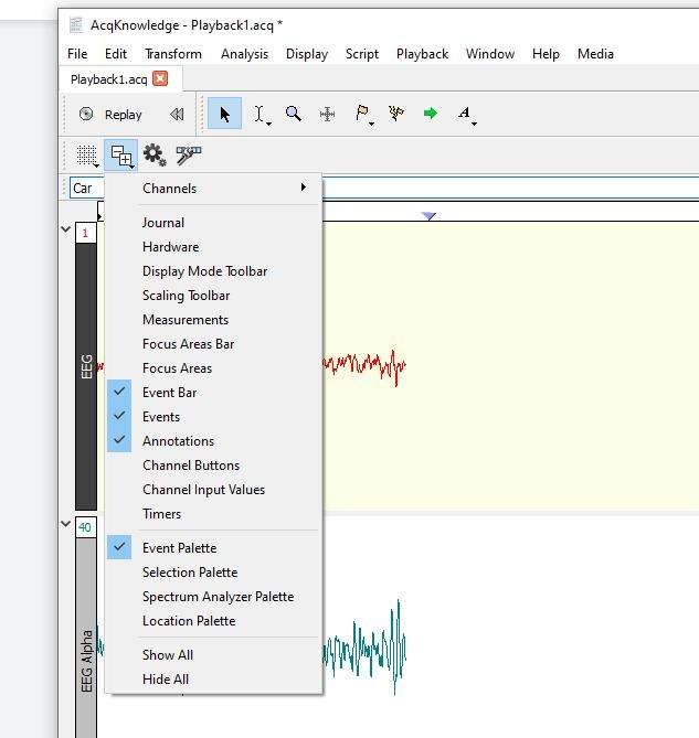

Viewing Events in Acqknowledge
  1. Enable the events bar in Acqknowledge.
  2. You can also display the "Event Palette" from the dropdown window.
  3. After a session, events will appear on the timeline alongside physiological data.
  4. Click on events to see their corresponding names
